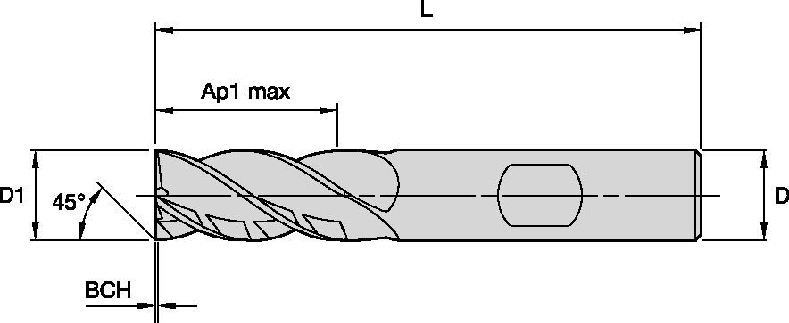

HARVI™ I TE • Chamfered • 4 Flutes • Weldon® Shank • Inch
HARVI™ I TE Four Flute End Mill for Roughing and Finishing Covering the Broadest Range of Applications and Materials
Número de material100149990
- Versatile solid carbide end mill for steels, stainless steel, cast iron, and high temperature alloys
- HARVI™ I TE solid carbide end mills cover a variety of operations, including dynamic milling, and extreme ramping operations
- HARVI™ I TE solid carbide end mills stand for maximum metal removal, maximum productivity, maximum benefit
- HARVI™ I TE solid carbide end mills feature asymmetrical divided flutes, variable helix, twisted end face, faceted eccentric relief, and chip gashes within the flutes
- Center cutting for plunging and ramping operations

Dimensiones de la herramienta: Configuración del canal: 4
Mango — Weldon cilíndrico
