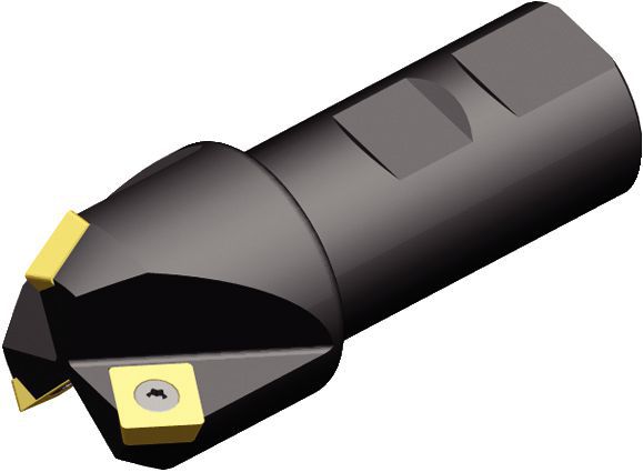

ChamferMill Max 60° • End Mill • Weldon Shank • Metric
End Mills
Material Number1024605
ISO Catalog ID32C3R038B32SSP12ANSI Catalog ID32C3R038B32SSP12
Chamfer Mill - End Mills 60° - Metric 1024605 - Kennametal
$492.85/each
  • Face MillingFace Milling
  • Shank - Cylindrical Weldon 2 FlatShank - Cylindrical Weldon 2 Flat
Drawings for 1024605
[D1] Effective Cutting Diameter32 mm
[D1] Effective Cutting Diameter1.2598 in
[D1MAX] Maximum Cutting Diameter44 mm
[D1MAX] Maximum Cutting Diameter1.7323 in
[D] Adapter / Shank / Bore Diameter1.2598 in
[L] Overall Length 101 mm
[L] Overall Length 3.9764 in
[L2] Head Length 40 mm
[L2] Head Length 1.575 in
[AP1MAX] 1st Maximum Cutting Depth10 mm
[AP1MAX] 1st Maximum Cutting Depth0.394 in
Number of Inserts3
Max RPM14670
Gage InsertSP__1204___
  • 60° countersinking and chamfering cutter.
