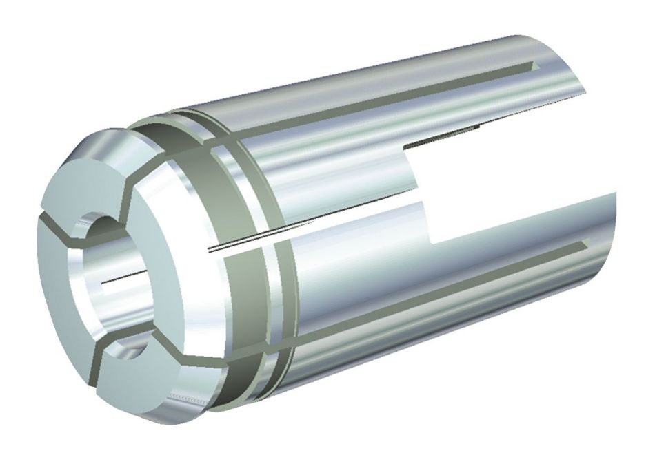

TG75 Solid Tap Collet
TG75 Single-Angle Solid Tap Collets
Nr materiału1017272
Nr katalogowy ISO75TGST050Nr katalogowy ASI75TGST050
Collets and Sleeves TG75 Single-Angle Solid Tap Collets

Tap Range M12 & M12.5 mm
Tap Range 1/2 in
Collet SeriesTG75
[D1] Clamping Diameter Maximum9.322 mm
[D1] Clamping Diameter Maximum0.367 in
[S10] Square Size 6.985 mm
[S10] Square Size 0.275 in
[L9] Clamping Hole Length 23.673 mm
[L9] Clamping Hole Length 0.932 in

For 75TGSTC, rubber-filled slots seal collet for coolant-fed tool applications.Can be used in all standard TG collet chucks.Provides Tremendous Grip (3:1 advantage) and accuracy for all drilling applications.Industry-standard ERICKSON™ single-angle collet system.0,13mm (.005") range of collapse.Grips on back taper and margin of drill for maximum feed rates and more accurate holes.Slot in back of collets acts as a drive for the tap square.Manufactured to DIN 6499 Class 2 accuracy.
