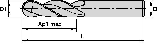

Drawings for 3881409
Material Number3881409
ISO Catalog IDHPHVBN156S4050
ANSI Catalog IDHPHVBN156S4050
GradeKC633M
[Z] Number of Flutes4
[D1] Effective Cutting Diameter3.97 mm
[D1] Effective Cutting Diameter0.1563 in
[D] Adapter / Shank / Bore Diameter4.763 mm
[D] Adapter / Shank / Bore Diameter0.1875 in
[AP1MAX] 1st Maximum Cutting Depth14.29 mm
[AP1MAX] 1st Maximum Cutting Depth0.5625 in
[L3] Usable Length14.29 mm
[L3] Usable Length0.5625 in
[L] Overall Length 50.8 mm
[L] Overall Length 2 in
