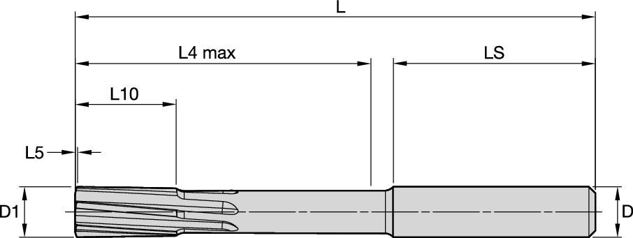

Drawings for 7029862
Material Number7029862
ISO Catalog IDKRS104A065000H7
ANSI Catalog IDKRS104A065000H7
GradeKCU05A
[D1] Reamer Diameter Minimum6.5 mm
[D1] Reamer Diameter Minimum0.2563 in
[L5] Reamer Point Length0.4 mm
[L5] Reamer Point Length0.0157 in
[L10] Cutting Edge Length16 mm
[L10] Cutting Edge Length0.6299 in
[L4] Maximum Reaming Depth 49 mm
[L4] Maximum Reaming Depth 1.929 in
[L] Overall Length 91 mm
[L] Overall Length 3.5827 in
[LS] Shank Length 36 mm
[LS] Shank Length 1.4173 in
[D] Adapter / Shank / Bore Diameter8 mm
[D] Adapter / Shank / Bore Diameter0.315 in
[Z] Number of Flutes4
