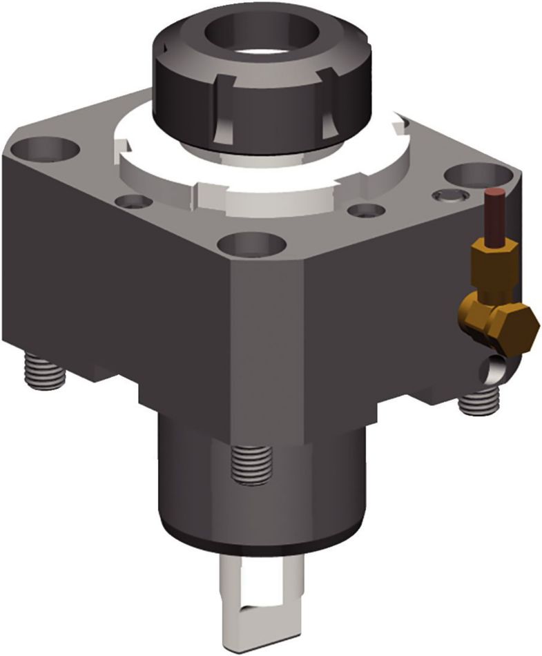

軸方向駆動工具 • ER™ • TACU002ER32DA61301864、TACU002ER32DA61301865、TACU002ER40DA61301840、TACU002ER40DA61301841
DMG森精機 • 軸方向駆動工具 • ER™ • MMC 002
製品番号6588940
ISO カタログ IDTACU002ER40DA61301841ANSIカタログIDTACU002ER40DA61301841

  • ER Solid ColletER Solid Collet
  • シャンク — スクリューオンシャンク — スクリューオン
  • コレット — ER DIN 6499コレット — ER DIN 6499

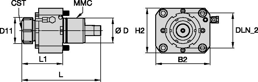

製品番号6588940
[CST] Catalog Collet SeriesER40
Machine Mount Code002
[B2] Overall Width 149.9 mm
[B2] Overall Width 5.9016 in
[D] Adapter / Shank / Bore Diameter59.9 mm
[D] Adapter / Shank / Bore Diameter2.3583 in
[D11] Lock Nut Diameter63 mm
[D11] Lock Nut Diameter2.4803 in
Lock Nut Diameter [DLN_2]85 mm
[DLN_2]ロックナット径 23.3465 in
[H2] Overall Height 108 mm
[H2] Overall Height 4.252 in
[L] Overall Length 189 mm
[L] Overall Length 7.4409 in
[L1] Gage Length94.5 mm
[L1] Gage Length3.7205 in
Torque Machine Spindle Nm100
Coolant Pressure Bar70
Coolant Pressure PSI1000
Coolant DeliveryI/E
[CS1] Coolant Supply Exit SizeM12X1 & G 1/8
Max RPM10000
Weight Kilograms7.92
Torque Newton Meters176
Torque Foot Pounds130
