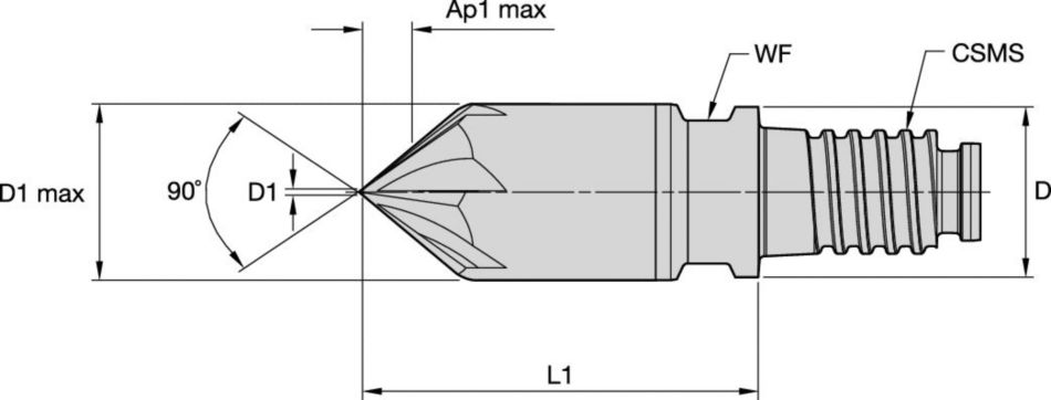

  • Helix Angle: 0°Helix Angle: 0°
Drawings for 6127404
Material Number6127404
ISO Catalog IDXADA1000X4CH45
ANSI Catalog IDXADA1000X4CH45
GradeKCPM15
Adapter Style Machine SideDUO-LOCK
[D1MAX] Maximum Cutting Diameter10 mm
[D1MAX] Maximum Cutting Diameter0.3937 in
[D1] Effective Cutting Diameter0.5 mm
[D1] Effective Cutting Diameter0.0197 in
[D] Adapter / Shank / Bore Diameter10 mm
[D] Adapter / Shank / Bore Diameter0.3937 in
[AP1MAX] 1st Maximum Cutting Depth2 mm
[AP1MAX] 1st Maximum Cutting Depth0.0787 in
[L1] Gage Length22.6 mm
[L1] Gage Length0.8898 in
[CSMS] System Size Machine SideDL10
[WF] Width of Flat 8 mm
[WF] Width of Flat 0.315 in
[Z] Number of Flutes4
KCPM15
KCPM15
  • Modular end mill for chamfering applications in steels and stainless steels.
