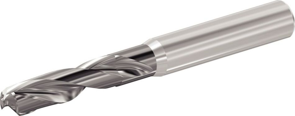

[D1] Drill Diameter M 14.288 mm
[D1] Drill Diameter M 0.5625 in
[L] Overall Length 155 mm
[L] Overall Length 6.1024 in
[L3] Flute Length 107 mm
[L3] Flute Length 4.2126 in
[L4] Maximum Drilling Depth 91 mm
[L4] Maximum Drilling Depth 3.5827 in
[L5] Drill Point Length3.595 mm
[L5] Drill Point Length0.1415 in
[LS] Shank Length 45.499 mm
[LS] Shank Length 1.7913 in
[D] Adapter / Shank / Bore Diameter14.288 mm
[D] Adapter / Shank / Bore Diameter0.5625 in
  • DrillingDrilling
  • Tool Dimensions: 2flute/3margin/coolantTool Dimensions: 2flute/3margin/coolant
  • Through Coolant: MQL (Minimum Quantity Lubricant): DrillingThrough Coolant: MQL (Minimum Quantity Lubricant): Drilling
KCK10
KCK10
Composition: Multilayered PVD AlCrN-based coated fine-grain carbide with superior surface finish.
Application: First choice for cast iron. Due to the uniquely developed coating combined with the state-of-the-art surface condition, this grade offers extraordinary wear resistance in abrasive materials at elevated cutting conditions.
  • YPC Beyond drills with through coolant for iron materials.
  • Material-specific SC drill specifically engineered to deliver best-in-class hole quality and longest tool life in cast iron, ductile iron, CGI, and ADI.
  • Y-TECH™ technology with uneven flute-to-flute angle creates unbalanced forces by design avoid chipping on margin lands.
  • Three-margin lands reduce pendulum motion by directing forces towards third margin for superior hole accuracy (cylindricity, constant diameter, hole straightness).
  • Corner chamfer avoids breakout when drilling through holes in gray iron.
  • KCK10™ Beyond grade contains multiple layers of PVD coating offering outstanding wear resistance for the drilling of cast irons.
