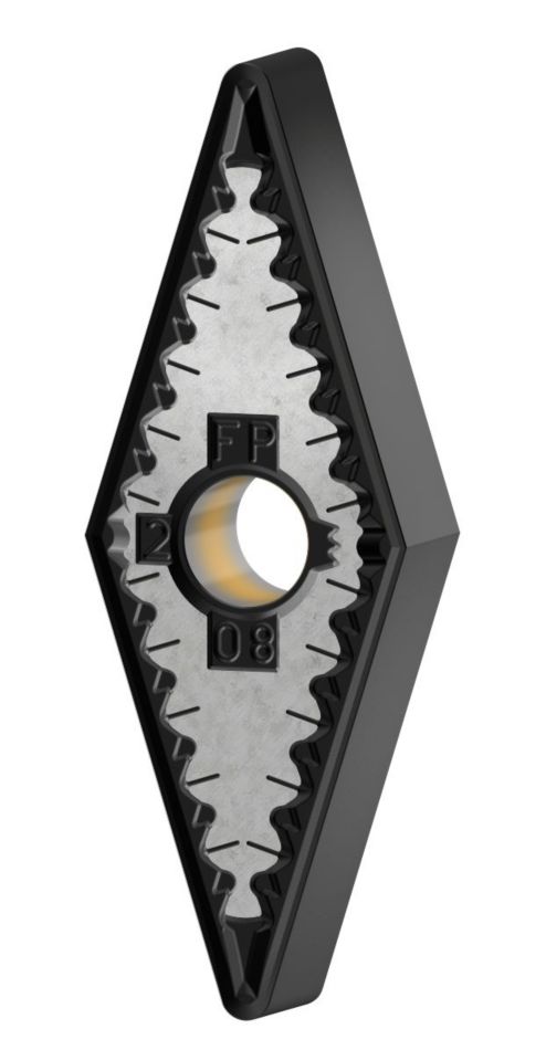

VNMG-FP
Kenloc™ Inserts
Material Number3758803
ISO Catalog IDVNMG160408FPANSI Catalog IDVNMG332FP
Kenloc™ VNMG ISO/ANSI Turning Insert 3758803 - Kennametal
C$54.08/each
Drawings for 3758803
GradeKCM15
[D] Insert IC Size9.525 mm
[D] Insert IC Size0.375 in
[D1] Insert Hole Size 3.81 mm
[D1] Insert Hole Size 0.15 in
[L10] Insert Cutting Edge Length16.606 mm
[L10] Insert Cutting Edge Length0.6538 in
[S] Insert Thickness4.76 mm
[S] Insert Thickness0.1875 in
[Rε] Corner Radius 0.8 mm
[Rε] Corner Radius 0.031 in
KCM15
KCM15
Composition: Nanostructured PVD TiAlN coated fine-grain carbide with a golden TiN top layer for better wear identification and superior surface finish.
Application: A state-of-the-art surface condition enhances low adhesion potential to stainless steel materials and offers superior chip evacuation even in low-pressure coolant applications. Applicable for stainless steel and high-temperature resistant materials.
  • Finishing geometry with positive rake face for chip control in difficult materials
