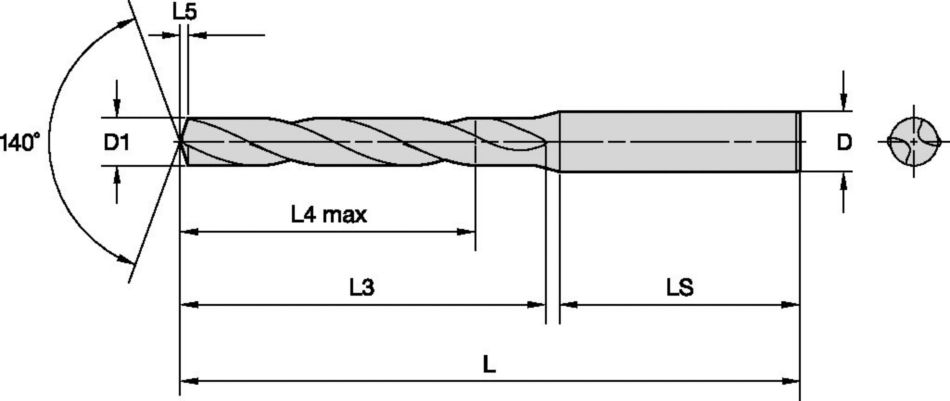

[D1] Drill Diameter M 10.7 mm
[D1] Drill Diameter M 0.4213 in
[L5] Drill Point Length1.947 mm
[L5] Drill Point Length0.0766 in
[LS] Shank Length 45 mm
[LS] Shank Length 1.772 in
[D] Adapter / Shank / Bore Diameter0.472 in
[L] Overall Length 118 mm
[L] Overall Length 4.646 in
[L3] Flute Length 71 mm
[L3] Flute Length 2.795 in
[L4] Maximum Drilling Depth 56 mm
[L4] Maximum Drilling Depth 2.205 in
