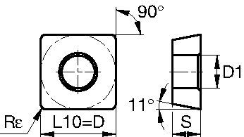

Drawings for 3760334
Material Number3760334
ISO Catalog IDSPMT120408MF
ANSI Catalog IDSPMT432MF
GradeKCM25
[D] Insert IC Size12.7 mm
[D] Insert IC Size0.5 in
[S] Insert Thickness4.76 mm
[S] Insert Thickness0.1875 in
[Rε] Corner Radius 0.8 mm
[Rε] Corner Radius 0.031 in
[D1] Insert Hole Size 5.5 mm
[D1] Insert Hole Size 0.2165 in
