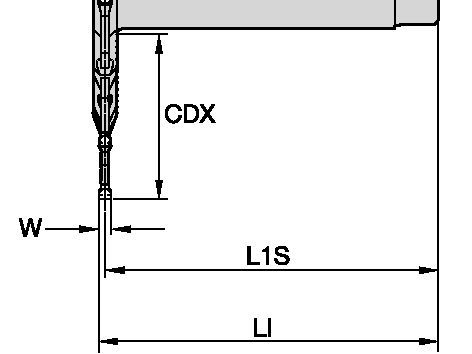

SAP Material Number ISO Catalog Number ANSI Catalog Number Insert Size [SSC] [D1] Effective Cutting Diameter [D1] Effective Cutting Diameter [CDX] Radial Maximum Depth of Cut [CDX] Radial Maximum Depth of Cut [D] Adapter / Shank / Bore Diameter [D] Adapter / Shank / Bore Diameter [D6] Hub Diameter [D6] Hub Diameter [L1] Gage Length [L1] Gage Length [L1S] Secondary Gage Length [L1S] Secondary Gage Length [THUB] Hub Thickness [THUB] Hub Thickness Number of Inserts Weight Kilograms Gage Insert Max RPM
5614851 KNSM100R11X12S022 KNSM100R11X12S022 12 100.0000 3.937 9.5400 .3750 22.0 .87 49.0000 1.930 51.8000 1.996 50.0000 1.969 51.8000 2.039 11 0.78 XCP12_____ 800
