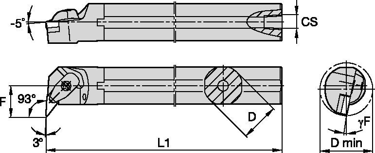

      A-DVUN-KC 93°
      Пластины Kenloc™
      Метрическая система
      Дюймовая система
      SAP Material Number 2441916
      ISO Catalog Number A32SDVUNR16KC04
      ANSI Catalog Number A32SDVUNR16KC04
      [D] Adapter / Shank / Bore Diameter 32.0 mm
      [D] Adapter / Shank / Bore Diameter 1.26 in
      [DM] Minimum Bore Diameter 40.0000 mm
      [DM] Minimum Bore Diameter 1.574 in
      [F] F Dimension 22.0000 mm
      [F] F Dimension .8661 in
      [L1] Tool Length 250.0000 mm
      [L1] Tool Length 9.842 in
      [CS] Coolant Supply Size 1/4-18 NPT
      [GAAP] Axial Rake Angle -3.000
      Gage Insert VN..160408
      Shim Screw ID Drive Size 15 IP
      Clamp Screw ID Drive Size 15 IP
