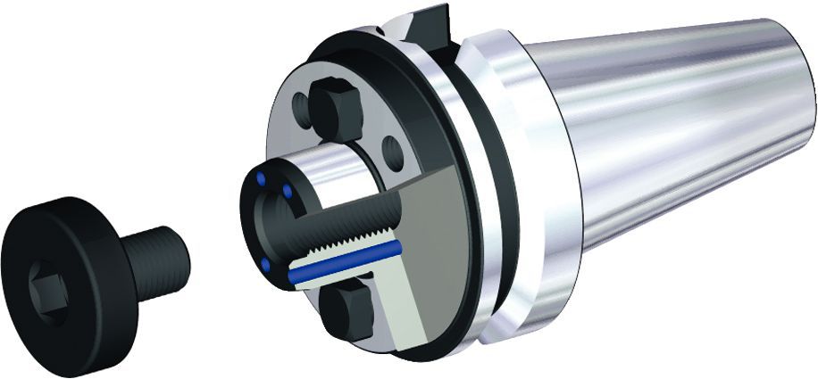

      Переходники для торцовых фрез — внутренний подвод СОЖ к режущей кромке

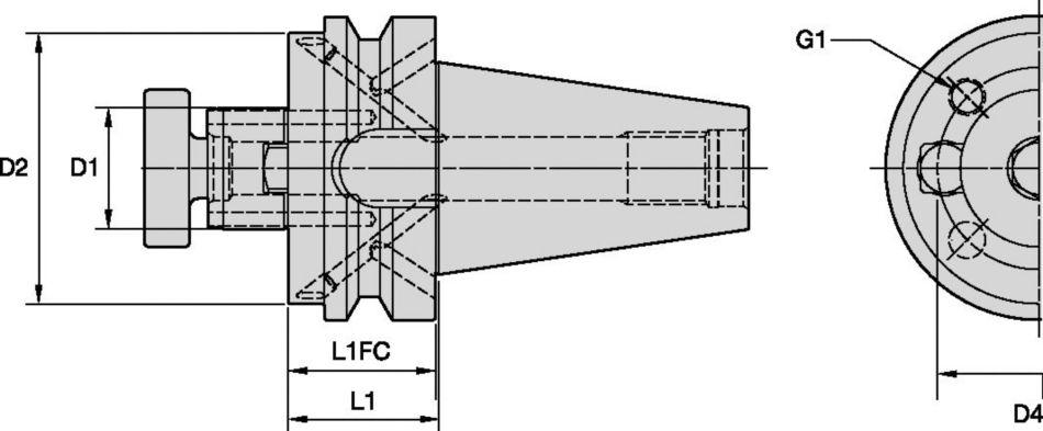

      SMC-BT форма B/AD, Метрическая
      Метрическая система
      Дюймовая система
      SAP Material Number 3857094
      ISO Catalog Number BTKV50BSMC40050M
      ANSI Catalog Number BTKV50BSMC40050M
      [D1] Adapter / Shank / Bore Diameter 40.0000 mm
      [D1] Adapter / Shank / Bore Diameter 1.570 in
      [D2] Body Diameter 1 Workpiece Side 89.3000 mm
      [D2] Body Diameter 1 Workpiece Side 3.520 in
      [D4] Bolt Circle 2 66.7000 mm
      [D4] Bolt Circle 1 2.626 in
      Bolt Circle Thread Size [G1] M12X1.75
      [L1] Gage Length 50.0000 mm
      [L1] Gage Length 1.969 in
      Gage Length Face Contact [L1FC] 48.5000 mm
      Gage Length Face Contact [L1FC] 1.910 in
      Cutter Retention Screw ID Drive Size 17 mm
      Weight Kilograms 4.46
