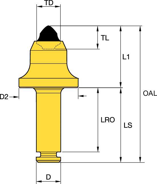

      Rotating Tungsten Carbide Pick • 25mm (.99 in) Shank
      External Retainer for Maximum Attachment • Cap Tip for a Variety of Conditions
      Метрическая система
      Дюймовая система
      SAP Material Number 4065449
      ISO Catalog Number T8 X
      ANSI Catalog Number T8 X
      Grade K3560
      [TD] Tip Diameter 24.435 mm
      [TD] Tip Diameter .9620 in
      [TL] Tip Length 23.864 mm
      [TL] Tip Length .9400 in
      [L1] Gage Length 63.468 mm
      [L1] Gage Length 2.498 in
      [D2] Body Diameter Workpiece Side 60.960 mm
      [D2] Body Diameter Workpiece Side 2.400 in
      [D] Shank/Bore Diameter 25.146 mm
      [D] Shank/Bore Diameter .9900 in
      [LRO] Retainer Offset Length 65.976 mm
      [LRO] Retainer Offset Length 2.597 in
      [LS] Shank Length 77.724 mm
      [LS] Shank Length 3.060 in
      [OAL] Overall Length 141.192 mm
      [OAL] Overall Length 5.558 in
