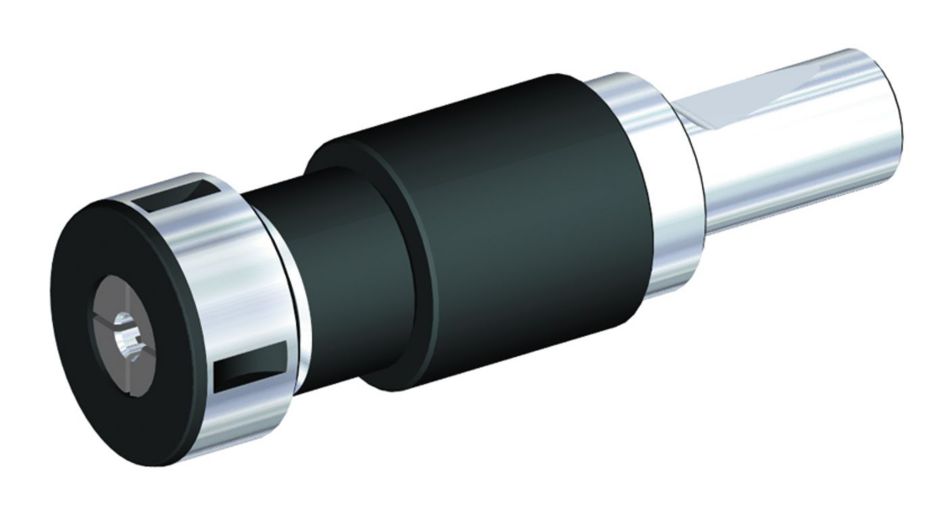

      Цанговые патроны TG с осевой компенсацией
      TG-SS

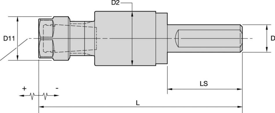

      SAP Material Number 1288221
      ISO Catalog Number SS075TCTG050
      ANSI Catalog Number SS075TCTG050
      [CST] Catalog Collet Series TG50
      [D11] Lock Nut Diameter 30.9560 mm
      [D11] Lock Nut Diameter 1.218 in
      [D2] Body Diameter 1 Workpiece Side 37.4650 mm
      [D2] Body Diameter 1 Workpiece Side 1.475 in
      [L] Overall Length 139.2170 mm
      [L] Overall Length 5.481 in
      [LS] Shank Length 50.8 mm
      [LS] Shank Length 2.0 in
      [LTN] Slide Tension 6.3500 mm
      [LTN] Slide Tension .2500 in
      [LCM] Slide Compression 7.6200 mm
      [LCM] Slide Compression .3000 in
      Torque Catalog Foot Pounds 75
      Weight Pounds 0.68
      [D] Adapter / Shank / Bore Diameter 19.05 mm
      [D] Adapter / Shank / Bore Diameter .75 in

      Характеристики и преимущества
      • Большая сила зажима (соотношение 3:1).
      • Антифрикционное устройство.
      • Компактная конструкция.
      • Регулировка нагрузки при запуске.
