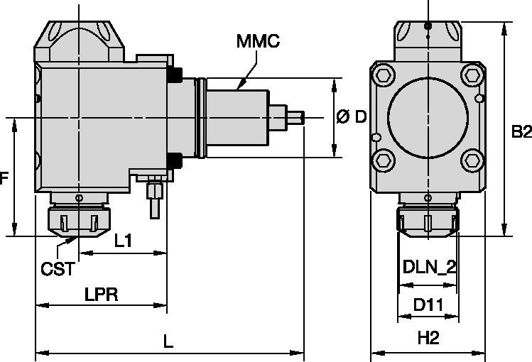

Sterowane narzędzie promieniowe • ER™ • TACU036ER32DR61301862
Doosan • napędzane oprawki promieniowe • ER • MMC 036
Właściwości i zalety
Seria obrabiarki:
  • Puma 2100, 2600 M/MS/Y/SY (24 stanowiska, BMT65)
  • Puma 2100, 2600 M/Y (12 stanowisk, BMT65)
  • Puma 3100 M/CM/Y/MY (12 stanowisk, BMT65)
  • Puma MX2000, 2500, 2600 T/ST/SY

SAP Material Number ISO Catalog Number ANSI Catalog Number [CST] Catalog Collet Series Machine Mount Code [B2] Overall Width [B2] Overall Width [D] Adapter / Shank / Bore Diameter [D] Adapter / Shank / Bore Diameter [D11] Lock Nut Diameter [D11] Lock Nut Diameter Lock Nut Diameter [DLN_2] HLD_LOCK_NUT_DIA_2_I [F] F Dimension [F] F Dimension [H2] Overall Height [H2] Overall Height [L] Overall Length [L] Overall Length [L1] Gage Length [L1] Gage Length [LPR] Protruding Length [LPR] Protruding Length Torque Machine Spindle Nm Coolant Pressure Bar Coolant Pressure PSI Coolant Delivery [CS1] Coolant Supply Exit Size Max RPM Weight Kilograms Torque Newton Meters Torque Foot Pounds
6589002 TACU036ER32DR61301862 TACU036ER32DR61301862 ER32 036 173.5000 6.830 65.0 2.559 50.0000 1.968 47.0000 1.850 85.0000 3.346 94.0000 3.700 220.5000 8.681 72.0000 2.834 108.5000 4.272 50.000 70.0 1000.0 I/E G 1/8 6000 11.04 136.000 100.0000
