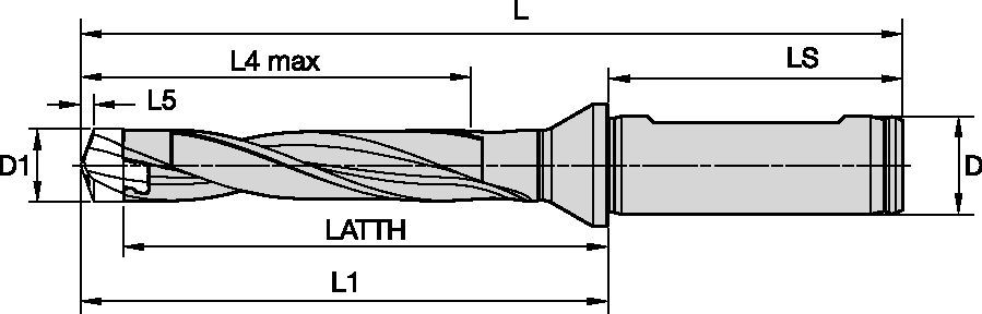

Nr materiału | 6372621 |
Nr katalogowy ISO | KTFS160R08SCF20M |
Nr katalogowy ANSI | KTFS160R08SCF20M |
[D1] Drill Diameter M | 16 mm |
[D1] Drill Diameter M | 0.63 in |
[D1MAX] Drill Diameter Maximum | 16.999 mm |
[D1MAX] Drill Diameter Maximum | 0.6692 in |
[L4] Maximum Drilling Depth | 136 mm |
[L4] Maximum Drilling Depth | 5.354 in |
[L] Overall Length | 213 mm |
[L] Overall Length | 8.3858 in |
[LATTH] Insert Attach LG Holder | 153.7 mm |
[LATTH] Insert Attach LG Holder | 6.0512 in |
[L1] Insert Gage Length | 163 mm |
[L1] Insert Gage Length | 6.4173 in |
[LS] Shank Length | 50 mm |
[LS] Shank Length | 1.9685 in |
[D] Adapter / Shank / Bore Diameter | 20 mm |
[D] Adapter / Shank / Bore Diameter | 0.7874 in |
[SSC] Insert Seat Size | U |
