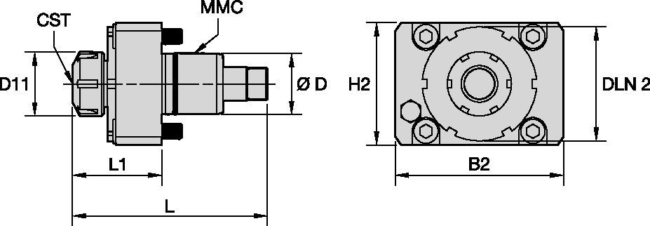

      Sterowane narzędzie osiowe • ER™ • TACU001ER25DA61301836, TACU001ER32DA61301834
      DMG Mori • napędzane oprawki osiowe • ER • MMC 001
      Metryczne
      Calowe
      SAP Material Number 6588935
      ISO Catalog Number TACU001ER25DA61301836
      ANSI Catalog Number TACU001ER25DA61301836
      [CST] Catalog Collet Series ER25
      Machine Mount Code 001
      [B2] Overall Width 110.0000 mm
      [B2] Overall Width 4.330 in
      [D] Adapter / Shank / Bore Diameter 40.0 mm
      [D] Adapter / Shank / Bore Diameter 1.574 in
      [D11] Lock Nut Diameter 42.0000 mm
      [D11] Lock Nut Diameter 1.653 in
      Lock Nut Diameter [DLN_2] 74.8000 mm
      HLD_LOCK_NUT_DIA_2_I 2.944 in
      [H2] Overall Height 80.0000 mm
      [H2] Overall Height 3.149 in
      [L] Overall Length 127.5000 mm
      [L] Overall Length 5.019 in
      [L1] Gage Length 57.0000 mm
      [L1] Gage Length 2.244 in
      Torque Machine Spindle Nm 32.000
      Coolant Pressure Bar 70.0
      Coolant Pressure PSI 1000.0
      Coolant Delivery I/E
      [CS1] Coolant Supply Exit Size M12X1
      Max RPM 12000
      Weight Kilograms 2.78
      Torque Newton Meters 105.000
      Torque Foot Pounds 77.0000
