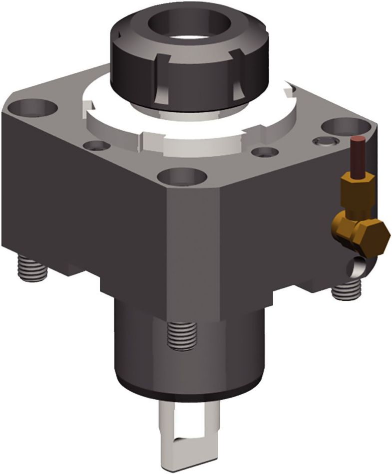

      Sterowane narzędzie osiowe • ER™ • TACU002ER32DA61301864, TACU002ER32DA61301865, TACU002ER40DA61301840, TACU002ER40DA61301841
      DMG Mori • napędzane oprawki osiowe • ER • MMC 002
      Metryczne
      Calowe
      SAP Material Number 6588940
      ISO Catalog Number TACU002ER40DA61301841
      ANSI Catalog Number TACU002ER40DA61301841
      [CST] Catalog Collet Series ER40
      Machine Mount Code 002
      [B2] Overall Width 149.9000 mm
      [B2] Overall Width 5.901 in
      [D] Adapter / Shank / Bore Diameter 59.9 mm
      [D] Adapter / Shank / Bore Diameter 2.358 in
      [D11] Lock Nut Diameter 63.0000 mm
      [D11] Lock Nut Diameter 2.480 in
      Lock Nut Diameter [DLN_2] 85.0000 mm
      HLD_LOCK_NUT_DIA_2_I 3.346 in
      [H2] Overall Height 108.0000 mm
      [H2] Overall Height 4.252 in
      [L] Overall Length 189.0000 mm
      [L] Overall Length 7.440 in
      [L1] Gage Length 94.5000 mm
      [L1] Gage Length 3.720 in
      Torque Machine Spindle Nm 100.000
      Coolant Pressure Bar 70.0
      Coolant Pressure PSI 1000.0
      Coolant Delivery I/E
      [CS1] Coolant Supply Exit Size M12X1 & G 1/8
      Max RPM 10000
      Weight Kilograms 7.92
      Torque Newton Meters 176.000
      Torque Foot Pounds 130.0000
