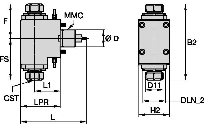

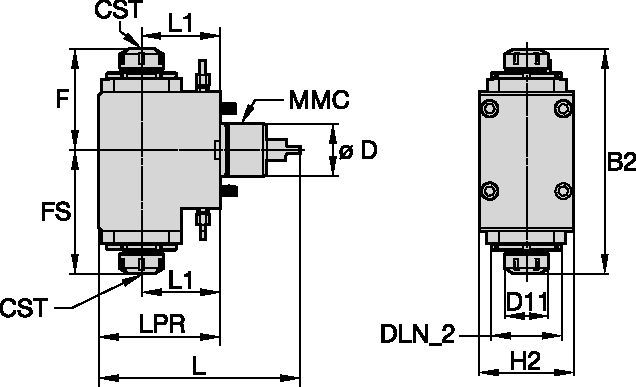

      Sterowane narzędzie promieniowe • ER™ • TACU002ER32DR61301866, TACU002ER40DR61301843
      DMG Mori • napędzane oprawki promieniowe • ER • MMC 002
      Metryczne
      Calowe
      SAP Material Number 6588962
      ISO Catalog Number TACU002ER40DR61301843
      ANSI Catalog Number TACU002ER40DR61301843
      MAR_ASTERISK *
      [CST] Catalog Collet Series ER40
      Machine Mount Code 002
      [B2] Overall Width 260.0000 mm
      [B2] Overall Width 10.236 in
      [D] Adapter / Shank / Bore Diameter 59.9 mm
      [D] Adapter / Shank / Bore Diameter 2.358 in
      [D11] Lock Nut Diameter 63.0000 mm
      [D11] Lock Nut Diameter 2.480 in
      Lock Nut Diameter [DLN_2] 80.0000 mm
      HLD_LOCK_NUT_DIA_2_I 3.149 in
      [F] F Dimension 105.5000 mm
      [F] F Dimension 4.153 in
      [FS] Secondary F Dimension 131.5000 mm
      [FS] Secondary F Dimension 5.177 in
      [H2] Overall Height 108.0000 mm
      [H2] Overall Height 4.252 in
      [L] Overall Length 230.0000 mm
      [L] Overall Length 9.055 in
      [L1] Gage Length 90.0000 mm
      [L1] Gage Length 3.543 in
      [LPR] Protruding Length 139.0000 mm
      [LPR] Protruding Length 5.472 in
      Torque Machine Spindle Nm 100.000
      Coolant Pressure Bar 25.0
      Coolant Pressure PSI 360.0
      Coolant Delivery I/E
      [CS1] Coolant Supply Exit Size G 1/8
      Max RPM 6000
      Weight Kilograms 21.56
      Torque Newton Meters 176.000
      Torque Foot Pounds 130.0000
