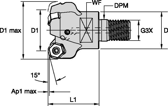

제품 번호 | 4153691 |
ISO 카탈로그 ID | KSHRHF040D05M16HN06 |
ANSI 카탈로그 ID | KSHRHF040D05M16HN06 |
[D1] Effective Cutting Diameter | 40 mm |
[D1] Effective Cutting Diameter | 1.575 in |
[D1MAX] Maximum Cutting Diameter | 53.15 mm |
[D1MAX] Maximum Cutting Diameter | 2.093 in |
[D] Adapter / Shank / Bore Diameter | 29 mm |
[D] Adapter / Shank / Bore Diameter | 1.1417 in |
[DPM] Pilot Diameter Machine Side | 17 mm |
[DPM] Pilot Diameter Machine Side | 0.669 in |
[G3X] Connection Thread Size External | M16 |
[L1] Gage Length | 40 mm |
[L1] Gage Length | 1.575 in |
[WF] Width of Flat | 22 mm |
[WF] Width of Flat | 0.866 in |
[AP1MAX] 1st Maximum Cutting Depth | 1.63 mm |
[AP1MAX] 1st Maximum Cutting Depth | 0.064 in |
Number of Inserts | 5 |
Weight Kilograms | 0.3 |
Max RPM | 15800 |
