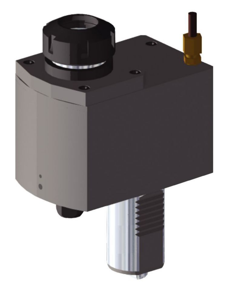

      Mazak • napędzane oprawki osiowe • ER • MMC 017
      Sterowane narzędzie osiowe • ER™ • TACU017ER32DA61301851
      Metryczne
      Calowe
      SAP Material Number 6588981
      ISO Catalog Number TACU017ER32DA61301851
      ANSI Catalog Number TACU017ER32DA61301851
      [CST] Catalog Collet Series ER32
      Machine Mount Code 017
      [B1] Front Clearance 84.0000 mm
      [B1] Front Clearance 3.307 in
      [B2] Overall Width 123.0000 mm
      [B2] Overall Width 4.842 in
      [D] Adapter / Shank / Bore Diameter 40.0 mm
      [D] Adapter / Shank / Bore Diameter 1.574 in
      [D11] Lock Nut Diameter 50.0000 mm
      [D11] Lock Nut Diameter 1.968 in
      Lock Nut Diameter [DLN_2] 47.0000 mm
      HLD_LOCK_NUT_DIA_2_I 1.850 in
      [F] F Dimension 50.0000 mm
      [F] F Dimension 1.968 in
      [H2] Overall Height 78.0000 mm
      [H2] Overall Height 3.070 in
      [L] Overall Length 200.0000 mm
      [L] Overall Length 7.874 in
      [L1] Gage Length 119.5000 mm
      [L1] Gage Length 4.704 in
      Torque Machine Spindle Nm 50.000
      Coolant Pressure Bar 70.0
      Coolant Pressure PSI 1000.0
      Coolant Delivery I/E
      [CS1] Coolant Supply Exit Size G 1/8
      Max RPM 6000
      Weight Kilograms 7.03
      Torque Newton Meters 136.000
      Torque Foot Pounds 100.0000
