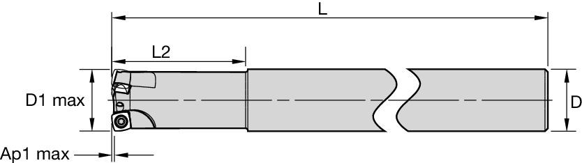

SAP Material Number | ISO Catalog Number | ANSI Catalog Number | First Choice | [D1MAX] Maximum Cutting Diameter | [D1MAX] Maximum Cutting Diameter | [D] Adapter / Shank / Bore Diameter | [D] Adapter / Shank / Bore Diameter | [D1] Effective Cutting Diameter | [D1] Effective Cutting Diameter | [L] Overall Length | [L] Overall Length | [L2] Head Length | [L2] Head Length | ||||||||||||||||||||||||||||||||||||||||||||||||||||||||||||||||||||||||||||||||||||||
5659947 | 7792VXD09CA025Z2R50 | 7792VXD09CA025Z2R50 | 25.0000 | .9840 | 25.0 | .984 | 11.7500 | .4630 | 200.0000 | 7.874 | 50.0000 | 1.969 |
定価:
$567.68
/各
価格::
数量
6024366 | 7792VXD09CA025Z3R50 | 7792VXD09CA025Z3R50 | 25.0000 | .9843 | 25.0 | .9843 | 11.9800 | .4717 | 200.0000 | 7.874 | 50.0000 | 1.968 |
定価:
$595.16
/各
価格::
数量
5661016 | 7792VXD09CA032Z3R70 | 7792VXD09CA032Z3R70 | 32.0000 | 1.259 | 32.0 | 1.259 | 18.9640 | .7466 | 250.0000 | 9.842 | 70.0000 | 2.755 |
定価:
$617.04
/各
価格::
数量
6024367 | 7792VXD09CA032Z4R70 | 7792VXD09CA032Z4R70 | 32.0000 | 1.259 | 32.0 | 1.259 | 18.9640 | .7466 | 250.0000 | 9.842 | 70.0000 | 2.755 |
定価:
$644.16
/各
価格::
数量
