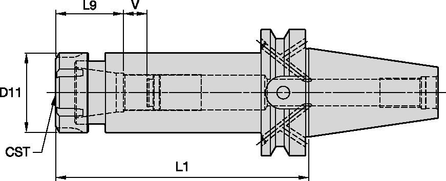

      SAP Material Number 1871541
      ISO Catalog Number BT50BER25150M
      ANSI Catalog Number BT50BER25150M
      [CST] Catalog Collet Series ER25
      [D11] Lock Nut Diameter 42.0000 mm
      [D11] Lock Nut Diameter 1.653 in
      [L1] Gage Length 150.0000 mm
      [L1] Gage Length 5.905 in
      [L9] Clamping Length 40.0000 mm
      [L9] Clamping Hole Length 1.570 in
      [V] Adjustment Range 60.0000 mm
      [V] Adjustment Range 2.362 in
      Weight Kilograms 4.36
      Counter Bore Collet Torque Nm 104.000
      Straight Collet Torque Nm 104
      Stop Screw ID Drive Size 4 mm & 5/32
