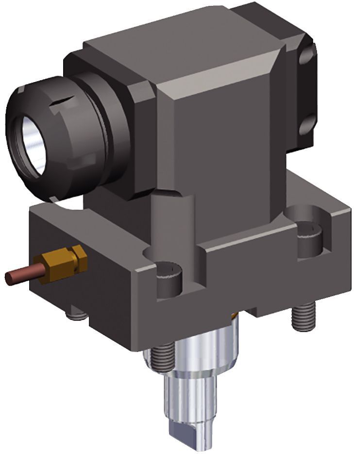

      DMG Mori • napędzane oprawki promieniowe • ER<sup>™</sup> • MMC 001

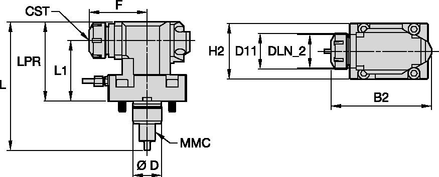

      Sterowane narzędzie osiowe • ER™ • TACU001ER25DR61301838, TACU001ER32DR61301835, TACU001ER25DR61301837
      DMG Mori • napędzane oprawki promieniowe • ER • MMC 001
      Metryczne
      Calowe
      SAP Material Number 6588934
      ISO Catalog Number TACU001ER32DR61301835
      ANSI Catalog Number TACU001ER32DR61301835
      [CST] Catalog Collet Series ER32
      Machine Mount Code 001
      [B2] Overall Width 138.0000 mm
      [B2] Overall Width 5.433 in
      [D] Adapter / Shank / Bore Diameter 40.0 mm
      [D] Adapter / Shank / Bore Diameter 1.574 in
      [D11] Lock Nut Diameter 50.0000 mm
      [D11] Lock Nut Diameter 1.968 in
      Lock Nut Diameter [DLN_2] 47.0000 mm
      HLD_LOCK_NUT_DIA_2_I 1.850 in
      [F] F Dimension 78.5000 mm
      [F] F Dimension 3.090 in
      [H2] Overall Height 78.0000 mm
      [H2] Overall Height 3.070 in
      [L] Overall Length 180.0000 mm
      [L] Overall Length 7.086 in
      [L1] Gage Length 85.0000 mm
      [L1] Gage Length 3.346 in
      [LPR] Protruding Length 111.0000 mm
      [LPR] Protruding Length 4.370 in
      Torque Machine Spindle Nm 32.000
      Coolant Pressure Bar 70.0
      Coolant Pressure PSI 1000.0
      Coolant Delivery I/E
      [CS1] Coolant Supply Exit Size G 1/8
      Max RPM 6000
      Weight Kilograms 6.19
      Torque Newton Meters 136.000
      Torque Foot Pounds 100.0000
