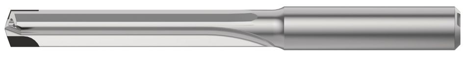

Vrtáky s PCD • B467 • 5 x D • Vnitřní chlazení • Stopka HA
PCD VRTÁKY • B467 • 5 x D • Vnitřní chlazení
Objednací číslo6761190
ISO katalogové IDB467A17000SPANSI katalogové IDB467A17000SP

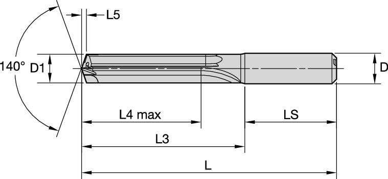

GradeKD1415
[D1] Drill Diameter M 17 mm
[D1] Drill Diameter M 0.6693 in
[L] Overall Length 143.5 mm
[L] Overall Length 5.6496 in
[L3] Flute Length 93 mm
[L3] Flute Length 3.6614 in
[L4] Maximum Drilling Depth 71 mm
[L4] Maximum Drilling Depth 2.7953 in
[L5] Drill Point Length2.8677 mm
[L5] Drill Point Length0.1129 in
[LS] Shank Length 48 mm
[LS] Shank Length 1.8898 in
[D] Adapter / Shank / Bore Diameter18 mm
[D] Adapter / Shank / Bore Diameter0.7087 in
