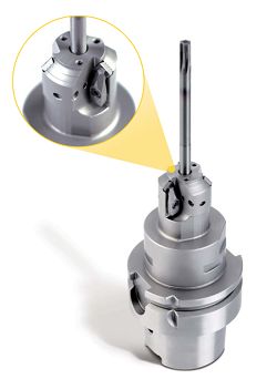

Our Romicron precision boring tool with closed loop boring means you can make simple and accurate tool adjustments one click at a time, down to 1µm. With a central dial, you can make adjustments to a single or multiple cutting tips. There’s no clamping screw or unpredictable backlash often found on conventional fineboring systems.
