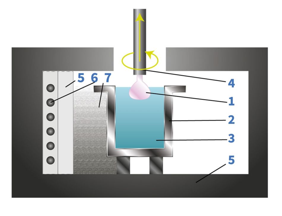

How the Czochralski Process Works?
In a Czochralski furnace, high-purity materials such as silicon are melted in a crucible at temperatures exceeding 1400°C. A small, oriented seed crystal is dipped into the molten material and slowly pulled upward while rotating. This controlled movement allows the molten material to solidify onto the seed, forming a single, cylindrical crystal known as a boule or ingot. The crucible may also rotate in the opposite direction to optimize heat distribution.
