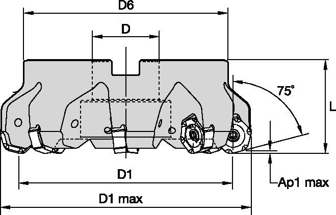

Material Number | 4047422 |
ISO Catalog ID | KSHRHF400HN5315C5 |
ANSI Catalog ID | KSHRHF400HN5315C5 |
[D1] Effective Cutting Diameter | 101.6 mm |
[D1] Effective Cutting Diameter | 4 in |
[D1MAX] Maximum Cutting Diameter | 120.522 mm |
[D1MAX] Maximum Cutting Diameter | 4.744 in |
[D] Adapter / Shank / Bore Diameter | 31.75 mm |
[D] Adapter / Shank / Bore Diameter | 1.25 in |
[D6] Hub Diameter | 97 mm |
[D6] Hub Diameter | 3.819 in |
[L] Overall Length | 44.962 mm |
[L] Overall Length | 1.77 in |
[AP1MAX] 1st Maximum Cutting Depth | 2.21 mm |
[AP1MAX] 1st Maximum Cutting Depth | 0.087 in |
Number of Inserts | 8 |
Weight Pounds | 3.91 |
Max RPM | 5800 |
