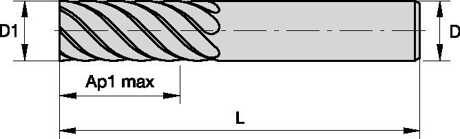

  • Helix Angle: 50°Helix Angle: 50°
Drawings for 1995582
Material Number1995582
ISO Catalog IDF4AJ1000AWM50L150
ANSI Catalog IDF4AJ1000AWM50L150
GradeKC633M
[D1] Effective Cutting Diameter10 mm
[D1] Effective Cutting Diameter0.3937 in
[D] Adapter / Shank / Bore Diameter10 mm
[D] Adapter / Shank / Bore Diameter0.3937 in
[AP1MAX] 1st Maximum Cutting Depth15 mm
[AP1MAX] 1st Maximum Cutting Depth0.5906 in
[L] Overall Length 76 mm
[L] Overall Length 2.9921 in
[Z] Number of Flutes4
