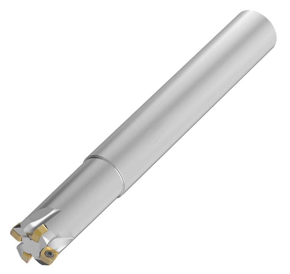

7792VXD09 Cylindrical Shank • Inch
High-Feed Milling Cutters
Material Number100035159
- Superior surface generation with integrated wiper facet.
- Maximum material removal rates.
- Suitable to machine HTA and titanium.
- Ultra-fine pitch cutters available to increase material removal rates, especially on high-temp alloys.
- Positive design to support lower cutting forces and long overhang usage.
- Ramping and plunge milling capabilities.
Spiral Circular
Slotting: Shoulder
Face Milling
Helical Milling
Ramping: Blank
Shank - Cylindrical Plain
Milling - Through Coolant
Pocketing
Counter Boring
Plunge Milling: Ball Nose
Inclined Square End Mill
