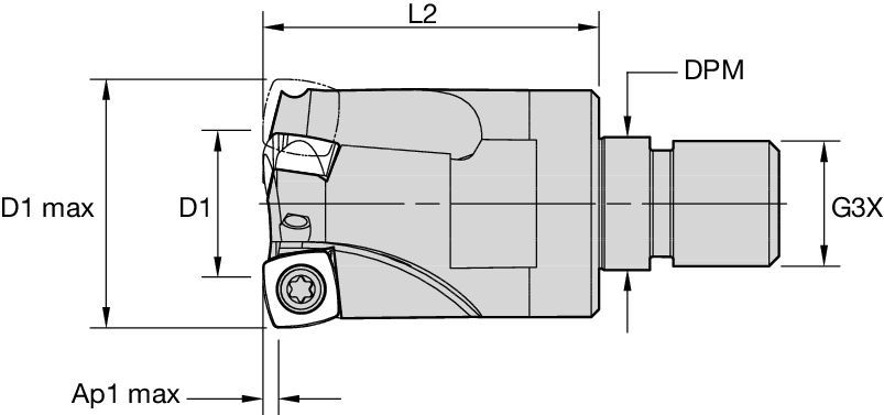

7792VXD09 Modular Head Screw-On • Metric
High-Feed Milling Cutters
Material Number100035160
- Superior surface generation with integrated wiper facet.
- Maximum material removal rates.
- Suitable to machine HTA and titanium.
Spiral Circular
Slotting: Shoulder
Face Milling
Helical Milling
Ramping: Blank
Shank - Screw-On
Milling - Through Coolant
Pocketing
Counter Boring
Plunge Milling: Ball Nose
Inclined Square End Mill
