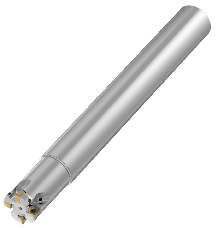

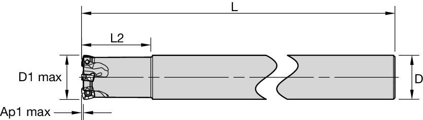

7792VXP06 Cylindrical Shank • Metric
High-Feed Milling Cutters
Material Number100035158
- Superior surface generation with integrated wiper facet.
- Maximum material removal rates.
- Suitable to machine HTA and titanium.
