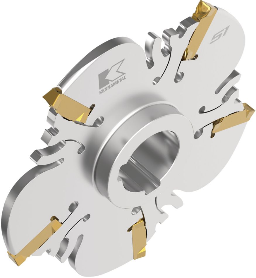

KNS® Slotting Mill • Arbour Mount • Metric
Material Number100043176
- Two-keyway hub design for gang slotting applications.
- From light to heavy machining, the positive SGP chipbreaker geometry ensures smooth cutting action, and efficient chip evacuation.
- The Double-V Design of the insert and the insert pocket securely holds the insert in place and minimizes radial runout.
- A unique self-clamping mechanism ensures easy insert exchange.
100055043
Slotting: Side
