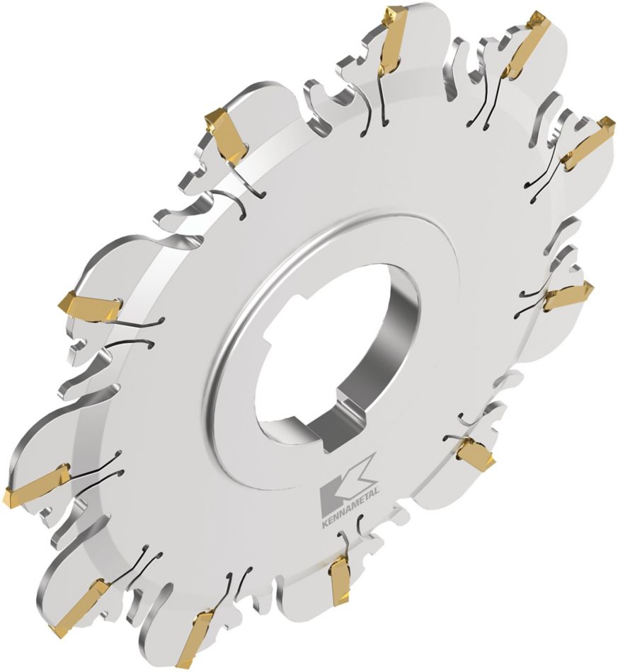

KNS® Slotting Mill • Arbour Mount • Reinforced Body • Metric
KNS® Slotting Mill • Reinforced Body • Arbour Mount
Material Number100043179
- Two-keyway hub design for gang slotting applications.
- From light to heavy machining, the positive SGP chipbreaker geometry ensures smooth cutting action, and efficient chip evacuation.
- The Double-V Design of the insert and the insert pocket securely holds the insert in place and minimizes radial runout.
- A unique self-clamping mechanism ensures easy insert exchange.
- Arbor mount style, reinforced cutter body.
