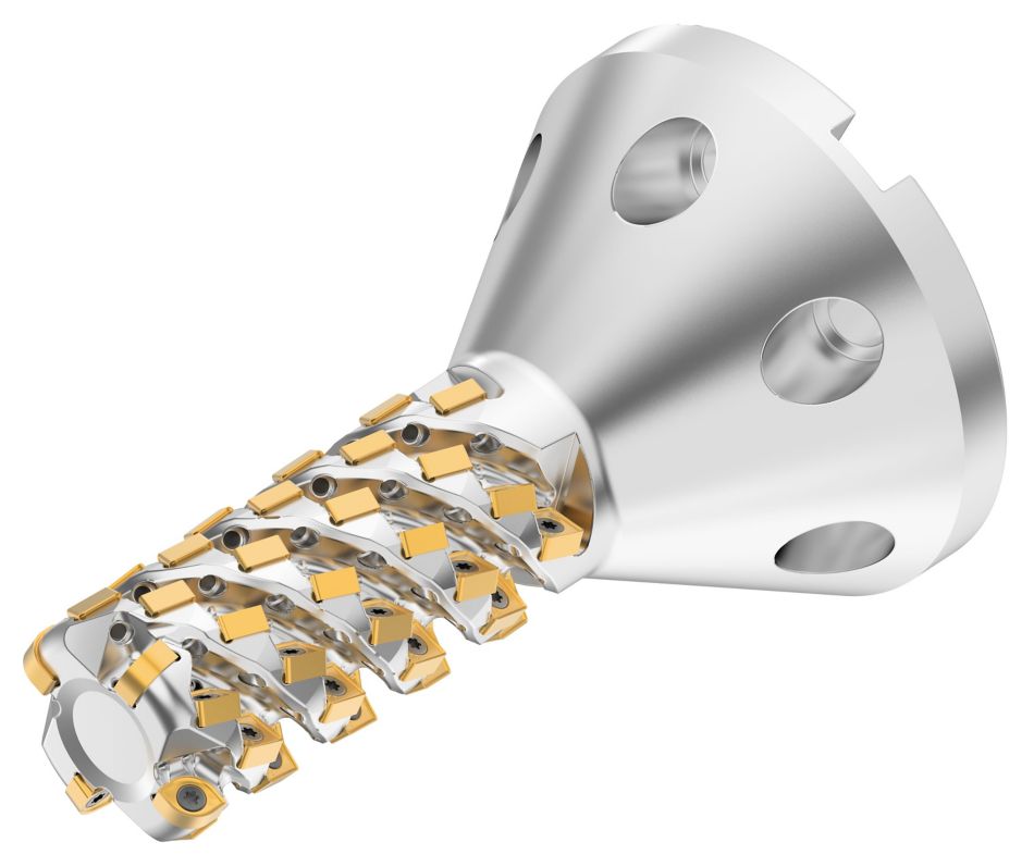

HARVI™ Ultra 8X • Helical Mill • SNHJ10 • Taper Flange Mount • For Corner Radius .250" (6,4mm) • Inch
Shoulder milling cutter with maximum tool stiffness for steel, stainless steel, and high-temperature alloys.
- Accomodates inserts with corner radii 6,4mm (.250") in the lead row.
- Designed for aerospace airframe structural component machining, targeting maximum metal removal rates (MRR).
- Internal coolant supply.
- Adjustable coolant nozzles support chip evacuation and control heat in the cutting zone.
- Large helix ensures hassle-free chip evacuation event at highest metal removal rates (MRR).
- Slotting: Shoulder Profiling
- Shank: Flange Mount Milling
- Side Milling/Shoulder Milling: Square End
- Side Milling/Shoulder Milling: Eased Chamfer
- Milling - Through Coolant
- Pocketing
