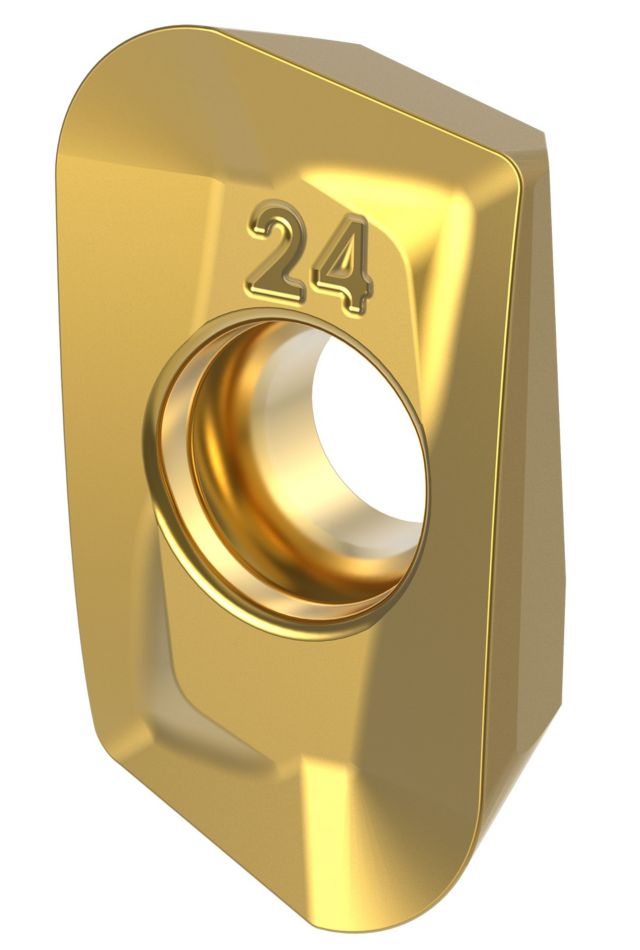

Inserts for Mill 1-10™ • EDCT-F.LDJ
Indexable Inserts
Material Number101239481
- Periphery ground and polished rake face.
- Roughing and finishing of aluminum alloys.
- Perfect floor surface finish.
- Ap1 max = 0.393" (10mm).
Insert Selection Guide
P1–P2 | .E..LD | KCPM40 | .S..GD | KCPM40 | .E..HD | KCPM40 |
P3–P4 | .E..LD | KCPK30 | .S..GD | KCPK30 | .E..HD | KCPK30 |
P5–P6 | .E..LD | KC725M | .S..GD | KC725M | .E..HD | KC725M |
M1–M2 | .E..LD | KCSM40 | .S..GD | KC725M | .E..HD | KCSM40 |
M3 | .E..LD | KCSM40 | .S..GD | KCPM40 | .E..HD | KCSM40 |
K1–K2 | .E..LD | KCK15 | .S..GD | KCK15 | .E..HD | KCK15 |
K3 | .E..LD | KCK20B | .S..GD | KCK20B | .E..HD | KCK20B |
N1–N2 | .F..LDJ | KC410M | .F..LDJ | KC422M | .E..LDJ | KC422M |
N3 | .F..LDJ | KC410M | .E..LDJ | KC422M | .E..LDJ | KC422M |
S1–S2 | .E..LD | KC725M | .S..GD | KC725M | .E..HD | KC725M |
S3 | .E..LD | KCSM40 | .S..GE | KCSM40 | .E..HD | KCSM40 |
S4 | .E..LD | KCSM40 | .S..GE | KCSM40 | .E..HD | KCSM40 |
H1 | .E..LD | KC510M | – | – | – | – |
