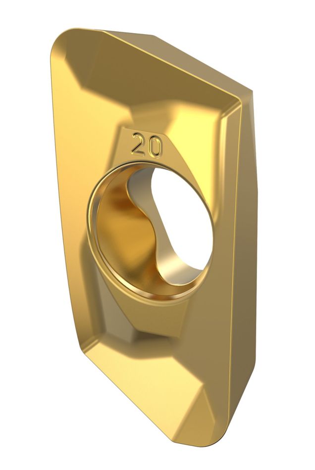

Inserts for Mill 1-18™ • EDCT-F.LDJ
Indexable Inserts
Material Number101239771
- Roughing and finishing of aluminum alloys.
- Periphery ground and polished rake face.
- Perfect floor surface finish.
- Ap1 max = 0.708" (18mm).
