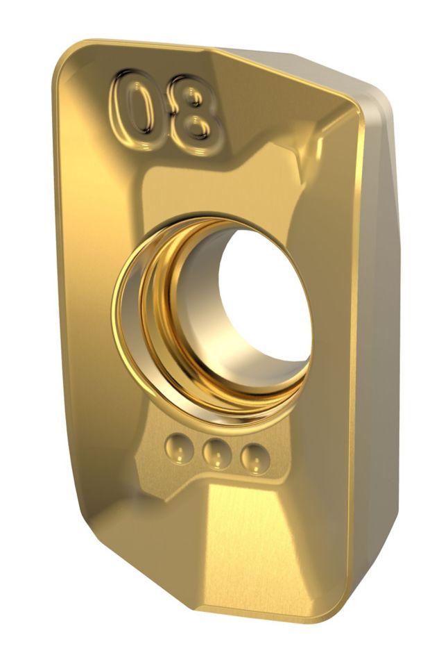

Inserts for Mill 1-7™ • EP07
Indexable Inserts
Material Number100004060
- Medium roughing and semi-finishing.
- Solution for austenitic stainless steel and super alloys.
- Medium feed rates.
- PSTS — Precision Pressed and Sintered to Size.
- Ap1 max = .276" (7mm).
