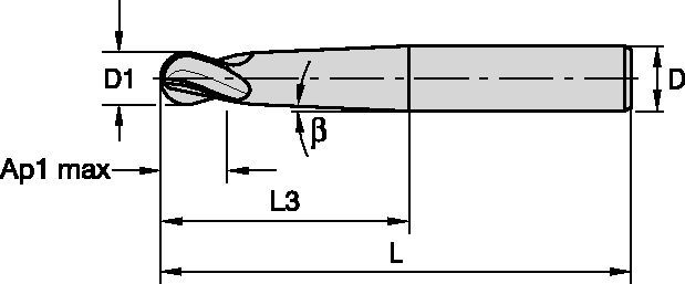

KenCut™ HM • F4AL-WLMX • Ball Nose • 4 Flutes • Tapered Neck • Plain Shank • Metric
KenCut™ HM Solid Carbide End Mill for Finishing of Steels and Hard Materials
Material Number100003483
- Centre cutting for plunging and ramping operations.
- Solid carbide end mills for machining of hard materials greater than 60HRC.
Side Milling/Shoulder Milling: Ball Nose
3D Profiling
Tool Dimensions: Flute Configuration: 4
Helix Angle: 30°
Corner Style: Ball Nose
