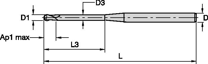

KenCut™ MM • F2AL-WM • Ball Nose • 2 Flutes • Extended Neck • Long • Plain Shank • Metric
KenCut™ MM Solid Carbide End Mill for Finishing of Steels and Hard Materials
  • Solid carbide end mill for micro machining and small parts machining.
  • Solid carbide end mill for machining of steels and hardened steels up to 67HRC.
  • 3D Profiling3D Profiling
  • Corner Style: Ball NoseCorner Style: Ball Nose
  • Tool Dimensions: Flute Configuration: 2Tool Dimensions: Flute Configuration: 2

SAP Material Number ISO Catalog Number ANSI Catalog Number Grade Adapter Style Machine Side [D1] Effective Cutting Diameter [D1] Effective Cutting Diameter [D] Adapter / Shank / Bore Diameter [D] Adapter / Shank / Bore Diameter [D3] Neck Diameter [D3] Neck Diameter [AP1MAX] 1st Maximum Cutting Depth [AP1MAX] 1st Maximum Cutting Depth [L3] Usable Length [L3] Usable Length [L] Overall Length [L] Overall Length [Z] Number of Flutes
6559904 F2AL0100AWM30E060 F2AL0100AWM30E060 KC639M Straight-Cylindrical 1.0000 .0394 4.0 .1575 0.9500 .0374 1.6000 .0630 6.0000 .2362 65.0000 2.559 2
