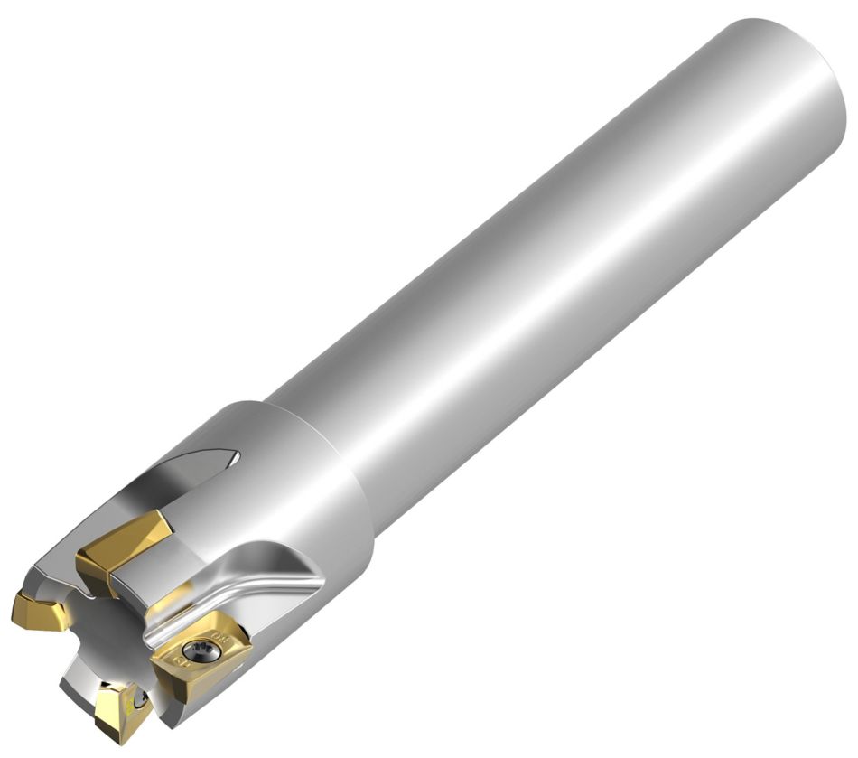

Mill 1-10™ End Mills • Cylindrical Shank • Inch
Indexable End Mills
Material Number100003094
- Mill 0° walls.
- Aggressive ramping rates.
- Generates superior surface finish.
- High RPM capabilities.
Face Milling
Helical Milling
Ramping: Blank
Slotting: Square End
Shank - Cylindrical Plain
Milling - Through Coolant
Pocketing
