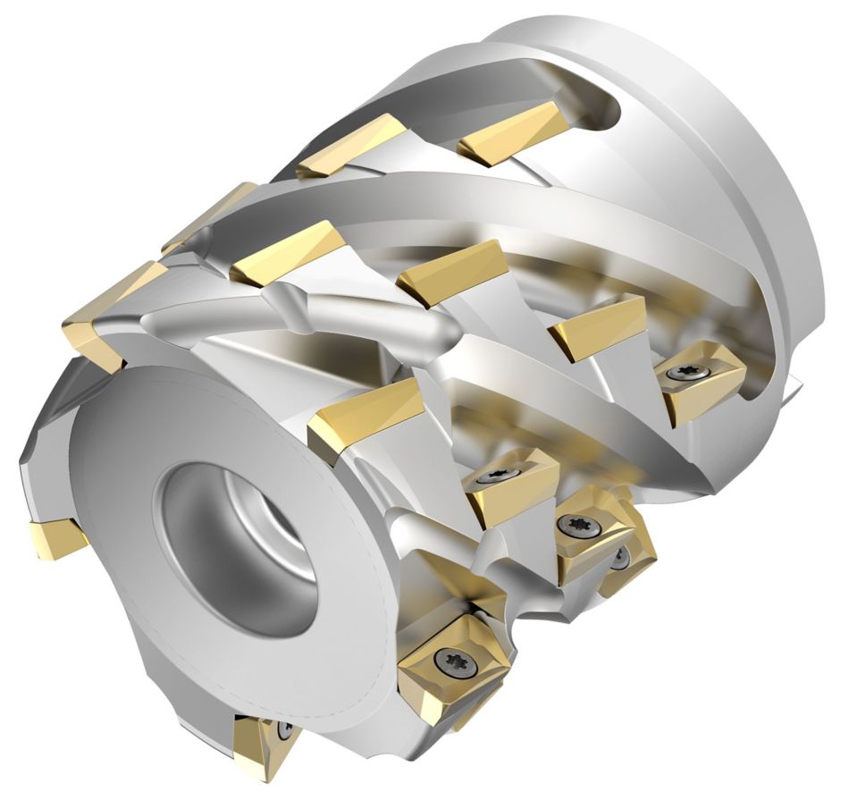

Mill 1-10™ Helical End Mills • Shell Mills • Inch
Indexable Helical End Mills
Material Number100003085
- Mill 0° walls.
- Aggressive ramping rates.
- Generates superior surface finish.
Face Milling
Helical Milling
Ramping: Blank
Slotting: Square End
Milling - Through Coolant
Milling - Side and Face
Pocketing
