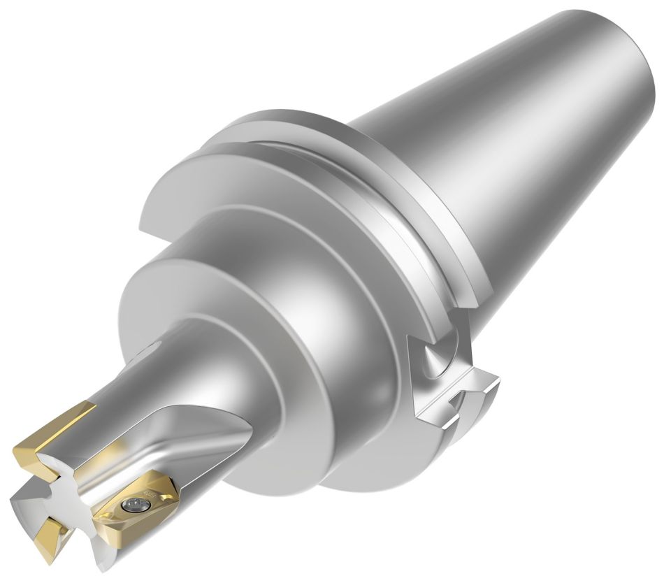

Mill 1-14™ End Mills • Steep Taper CV40 • Inch
Indexable End Mills
Material Number100003104
- Mill 0° walls.
- Aggressive ramping angles.
- Generates superior surface finish.
- High RPM capabilities.
Face Milling
Helical Milling
Ramping: Blank
Slotting: Square End
Milling - Through Coolant
Pocketing
Shank - SK CAT(CV) ANSI B5.50
