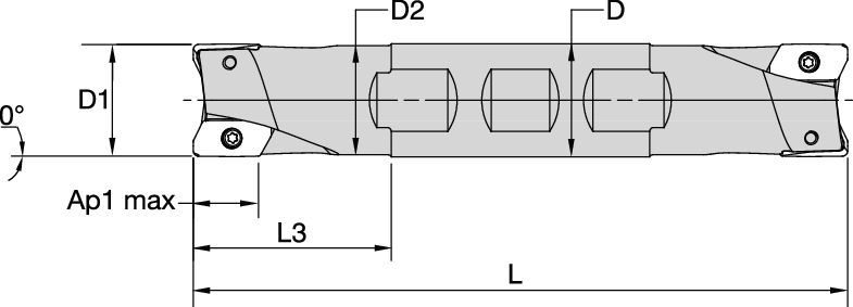

Mill 1-14™ End Mills • Weldon Shank • Double Ended • Inch
Indexable End Mills
Material Number100003103
- Mill 0° walls.
- Aggressive ramping angles.
- Generates superior surface finish.
- High RPM capabilities.
Face Milling
Helical Milling
Ramping: Blank
Slotting: Square End
Milling - Through Coolant
Shank - Cylindrical Weldon 2 Flat
Pocketing
