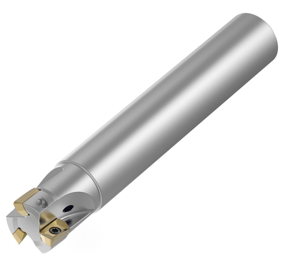

Mill 1-7™ • End Mills • Cylindrical Shank • Inch
Indexable End Mills
Material Number100004062
- Mill 90° walls.
- Aggressive ramping rates.
- High speed machining.
- Ramp, slot, plunge, face, and shoulder milling.
Face Milling
Helical Milling
Ramping: Blank
Slotting: Square End
Shank - Cylindrical Plain
Milling - Through Coolant

Insert Selection Guide
– | wear | toughness | ||||
P1–P2 | .S..GE | KC725M | .S..GE | KCPK30 | .S..GE | KCPM40 |
P3–P4 | .S..GE | KC725M | .S..GE | KCPK30 | .S..GE | KCPM40 |
P5–P6 | .S..GE | KC725M | .S..GE | KCPK30 | .S..GE | KCPM40 |
M1–M2 | .S..GE | KC522M | .S..GE | KC725M | .S..GE | KCPM40 |
M3 | .S..GE | KC725M | .S..GE | KCPK30 | .S..GE | KCPM40 |
K1–K2 | .S..GE | KCPK30 | .S..GE | KCPK30 | .S..GE | KCPK30 |
K3 | .S..GE | KCPK30 | .S..GE | KCPK30 | .S..GE | KCPK30 |
N3 | – | – | – | – | – | – |
S1–S2 | .S..GE | KC522M | .S..GE | KC725M | .S..GE | KC725M |
S3 | .S..GE | KC725M | .S..GE | KC725M | .S..GE | KCPM40 |
S4 | .S..GE | KC522M | .S..GE | KC725M | .S..GE | KC725M |
H1 | – | – | – | – | – | – |
Mill 1-7™ • Recommended Starting Feeds [mm/th] | |||||||||||||||
.S..GE | 0,23 | 0,47 | 0,69 | 0,17 | 0,34 | 0,50 | 0,13 | 0,26 | 0,37 | 0,11 | 0,22 | 0,32 | 0,10 | 0,20 | 0,30 |
Mill 1-7™ • Recommended Starting Feeds [IPT] | |||||||||||||||
.S..GE | 0.009 | 0.018 | 0.027 | 0.007 | 0.013 | 0.019 | 0.005 | 0.010 | 0.014 | 0.004 | 0.009 | 0.013 | 0.004 | 0.008 | 0.012 |
Mill 1-7™ • Recommended Starting Speed [m/min] | ||||||||||||||||
Grade | KC522M | KC725M | KCPK30 | KCPM40 | KCSM30 | |||||||||||
Chip Thickness hex mm | Min | Max | Min | Max | Min | Max | Min | Max | Min | Max | ||||||
Material Group | Max | Start | Min | Max | Start | Min | Max | Start | Min | Max | Start | Min | Max | Start | Min | |
P | 1 | 330 | 285 | 270 | 260 | 230 | 215 | 455 | 395 | 370 | 295 | 260 | 245 | 370 | 320 | 300 |
2 | 275 | 240 | 200 | 220 | 190 | 160 | 280 | 255 | 230 | 250 | 215 | 180 | 305 | 270 | 220 | |
3 | 255 | 215 | 175 | 200 | 170 | 140 | 255 | 230 | 205 | 230 | 195 | 160 | 285 | 240 | 195 | |
4 | 225 | 185 | 150 | 180 | 150 | 120 | 225 | 185 | 160 | 205 | 170 | 135 | 250 | 205 | 165 | |
5 | 185 | 170 | 150 | 150 | 135 | 120 | 190 | 170 | 150 | 170 | 155 | 135 | 205 | 190 | 165 | |
6 | 165 | 125 | 100 | 130 | 100 | 80 | 160 | 135 | 110 | 150 | 115 | 90 | 185 | 140 | 110 | |
M | 1 | 205 | 180 | 165 | 170 | 150 | 135 | 205 | 185 | 155 | 195 | 170 | 155 | 225 | 180 | 170 |
2 | 185 | 160 | 130 | 155 | 130 | 110 | 185 | 160 | 140 | 175 | 150 | 125 | 205 | 160 | 135 | |
3 | 140 | 120 | 95 | 115 | 100 | 80 | 145 | 130 | 115 | 130 | 115 | 90 | 155 | 125 | 95 | |
K | 1 | 230 | 205 | 185 | – | – | – | 295 | 265 | 240 | – | – | – | – | – | – |
2 | 180 | 160 | 150 | – | – | – | 235 | 210 | 190 | – | – | – | – | – | – | |
3 | 150 | 135 | 120 | – | – | – | 195 | 175 | 160 | – | – | – | – | – | – | |
N | 1 | – | – | – | – | – | – | – | – | – | – | – | – | – | – | – |
2 | – | – | – | – | – | – | – | – | – | – | – | – | – | – | – | |
3 | – | – | – | – | – | – | – | – | – | – | – | – | – | – | – | |
S | 1 | 40 | 35 | 25 | 35 | 30 | 25 | – | – | – | 40 | 35 | 30 | 45 | 40 | 30 |
2 | 40 | 35 | 25 | 35 | 30 | 25 | – | – | – | 40 | 35 | 30 | 45 | 40 | 30 | |
3 | 50 | 40 | 25 | 45 | 35 | 25 | – | – | – | 50 | 40 | 30 | 55 | 45 | 30 | |
4 | 50 | 45 | 35 | 50 | 45 | 30 | 50 | 45 | 35 | 55 | 50 | 35 | 60 | 55 | 40 | |
H | 1 | 120 | 90 | 70 | – | – | – | – | – | – | – | – | – | 135 | 100 | 75 |

Mill 1-7™ • Ramping Angles [mm] | ||||
cutting diameter | max ramp angle to non-cutting corner tangent | DH min (min hole diameter) | DHI min (min flat-bottomed hole diameter) | max diameter (no flat bottom) |
12 | 5,49° | 14,62 | 21,43 | 24 |
16 | 2,92° | 22,52 | 28,04 | 32 |
20 | 2,01° | 30,51 | 36,49 | 40 |
