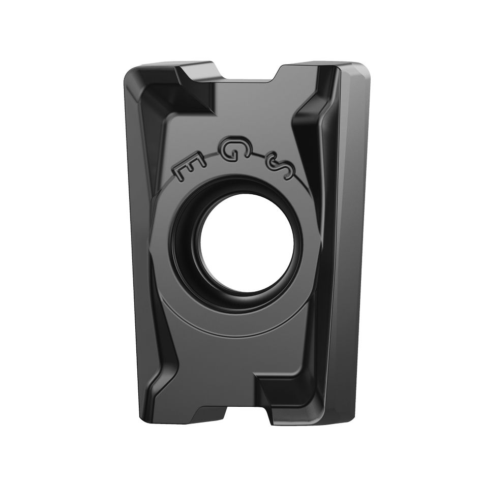

Mill 4-11™ • Insert • LNGU11-SGEM • Heavy
Shoulder Milling • Insert • LNGU11-SGEM • Heavy
Material Number100068158
- -SGEM geometry is for heavy applications.
- Shoulder milling insert for steels, stainless steel, and cast iron.
