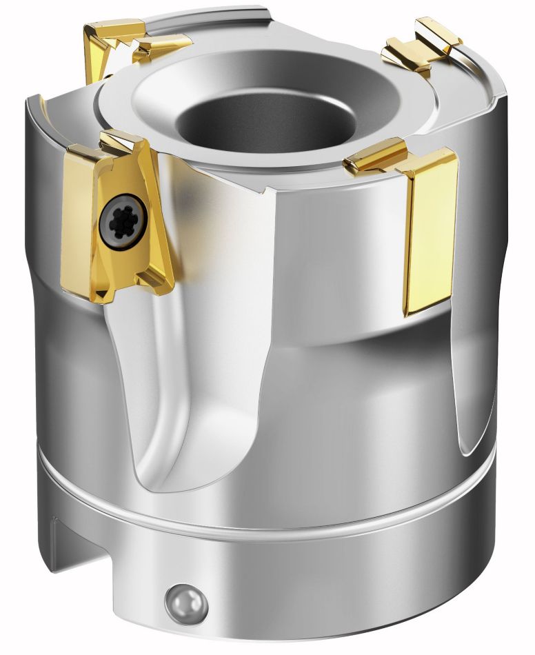

Mill 4-11™ • Shell Mill • Inch
Shoulder Milling • Shell Mill
Material Number100074441
- Shoulder milling cutter.
- Superior wall and surface finish capabilities.
- True 90° capabilities. Stepless solution when using multiple steps.
- Engineered to run up to .433″ (11mm) depth of cut.
- Effective internal coolant feature, reaching the cutting edge precisely.
