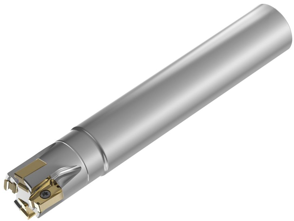

Mill 4-15™ • End Mill • Cylindrical Shank • Metric
Shoulder Milling • End Mill • Cylindrical Shank
Material Number100001076
- Shoulder milling cutter.
- Superior wall and surface finish capabilities.
- True 90° capabilities. Stepless solution when using multiple steps.
- Engineered to run up to .610″ (15,5mm) depth of cut.
- Effective internal coolant feature, reaching the cutting edge precisely.
Face Milling
Slotting: Square End
Shank - Cylindrical Plain
Milling - Through Coolant
